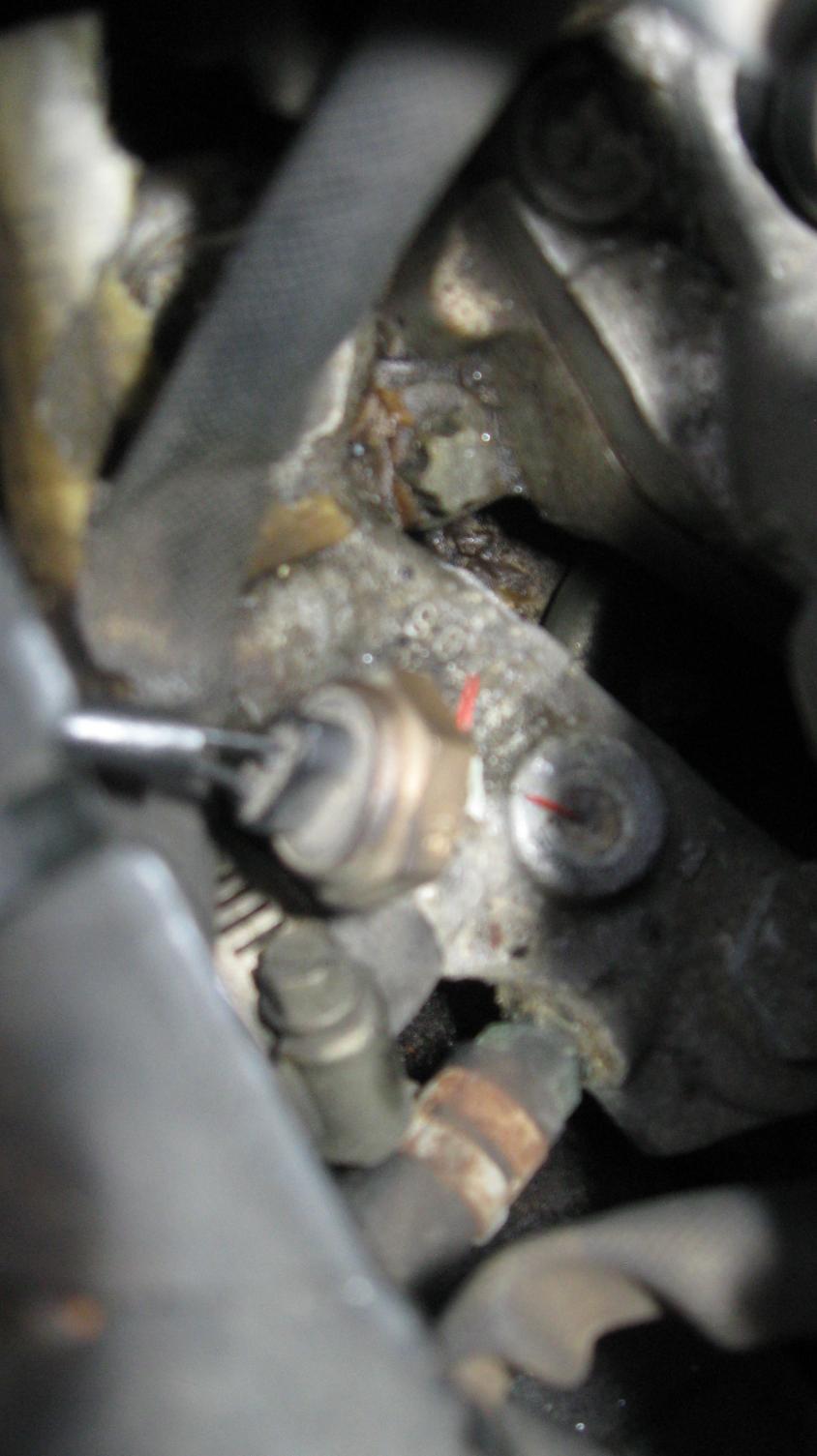

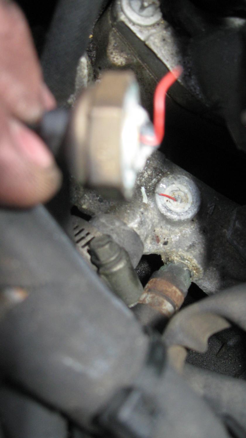

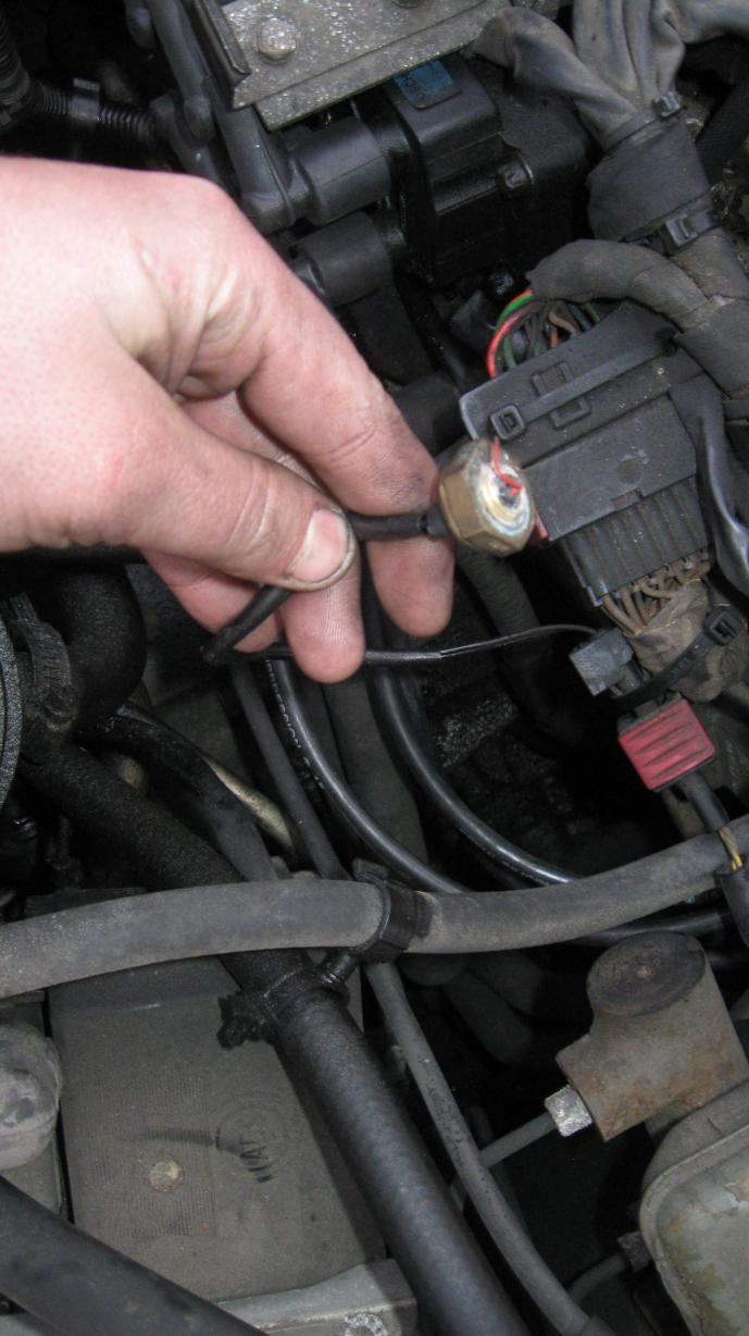

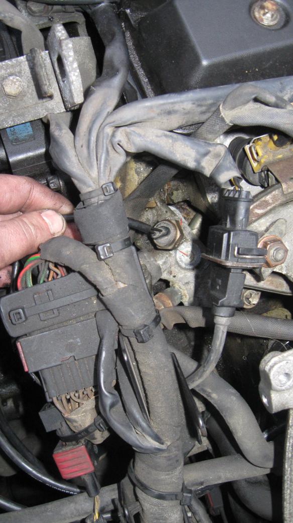

ok so i found out that the line was my fuel pressure regulator lol im a tard soo anyway the problem is still there...AND then i found this.. Anybody know what this is...a temp sensor or something is my guess.....
it was the coolant temp sender...and of course i had to buy the new housing that that was bolted into...so after a long bit of searching i replaced the coolant temp sensor, coolant temp sender, the thermostat adapter housing. She runs great now..i didnt know a coolant sensor could do that to a car...weird...but the day i got her fixed as i was on my way home i snapped my clutch cable :soo its just one thing after another lol..pics soon
