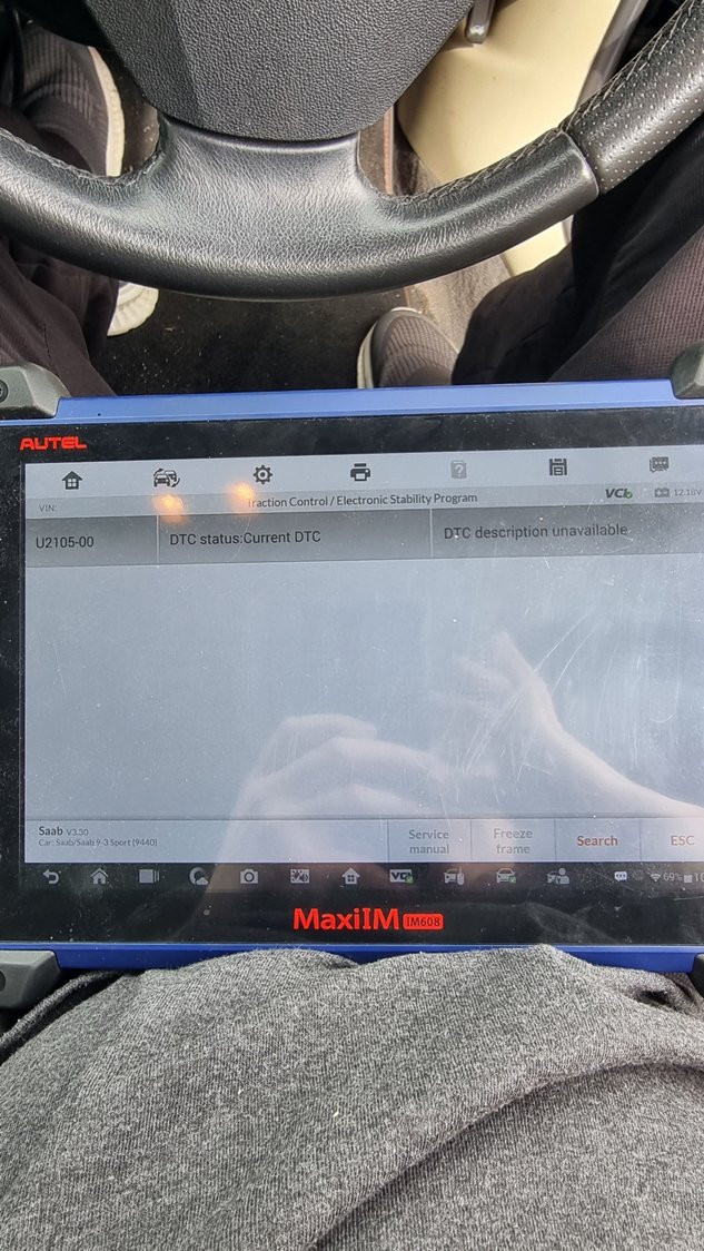

93 Vector Sport 2008 1.9 TID
Fault codes:
1. Traction Control/Electronic Stability Program
U2105-00.
2. Electro Hydraulic Power Steering
U2105-00
U2105-71
Story:
Bought this vehicle, message on display Limited Performance.
Vehicle starts, but Very slowly accelerate until 2000/2500 RPM. Once it reaches that RPM, it runs like a Rocket
( Fast and active ish), so basically normal.
problem is not here as i found MOD in the fuse box. It has extra relay attached with 3 wires connected to fuse box bundle wires .
So i removed Relay from the fuse box and vehicle does not starting at all, no crank, nothing, just message on display about Stability/ Traction control failure, contact service.
Fault codes already wrote at beginning.
Any ideas?
Someone bypass this main fault with extra relay attached to bundle of wires going to fuse box, wires not cut, just sliced and connected to fuse box wire bundle.
I can start and drive vehicle with relay attached, but i dont have power at all up to 2500 RPM, it is extremely slow, dangerous, but it is fine after it reaches over, fast and active ish.
With Diagnostic Autel IM608, i am able to read codes from ECU and all other modules when relay is connected,
but i am not able to read ECU when it is Not connected, only those fault codes on the top of this post. Only by entering vin manually i get to scan those codes, but not ECU.
