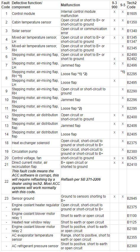

Originally Posted by LisaHamiltonEu
I also got a problem with AC , any idea where I can solve it ?
Hi Lisa
there are numerous faults that could apply for your car. I'm nut sure if your display is same, but for mine 2001 Saloon I ran diagnostics by pressing the AUTO and OFF button at the same time. The AC system run a calibration process and might identify your problem. The number of faults appear in the left as 1, 2,3 and so on, and the error code on the right side. Once identified you can start looking for the remedy and procedures/videos can be found online. Common error code is 08/09 LH/RH air mixing flaps. These are are plastic levers regulating air blow and is a week part the is known to break at some point. Repair kits are available with improved quality and would last the lifetime of the car.
Another issue could be the blower fan located between the wipers. Typically related to the brushes or resistor, which can be replaced. Or just replace with a new or second hand fan.
How to run diagnosis is described in this video: 00:00 to 01:10 following a description of how to chech and resolve the spesific findings:
